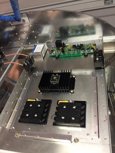

Brief Description:  Installed EXBus II panel
Used stainless 3/4 inch 6-32 screws and rubber standoffs to mount the ExBus panel to the avionics shelf. Ran a cable with three 22 ga wires to where the flap servo will mount. Also ran the Skytek fuel sensor cable to the front through the torque tube tunnel. Drilled a hole through the foot on the skytek tank and secured with a 6-32 screw and nut. Was going to clamp the fuel and return hose to the Skytek tank but ran out of small clamps. Will purchase those tomorrow.
ExBus II panel in place

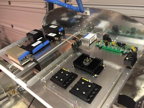

Avionics shelves pre wiring

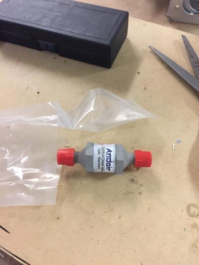

Andair one way check valve for return line
