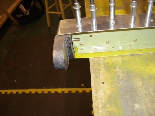

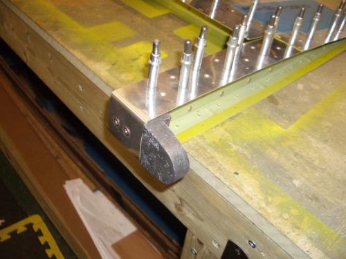

The elevator has a honking great piece of lead in it, which is used as a counterbalance for the mass of the elevator itself to keep the control forces low under aerodynamic load. The LH and RH elevator come with the same type of lead weight inn the kit, but the one for this side needs to be cut down since the other elevator will be heavier. (Why? Wait and see!)
So it was into the drill press with one piece of lead, and after lots of lubrication - and one broken bandsaw blade (careless!) - I had the lead in the right shape for now. Further mass will be skimmed off it later, for fine balance once the elevator is painted - but for now, it's fine.

Counterbalance weight, with cut-out visible.
Another view of the counterbalance in position
