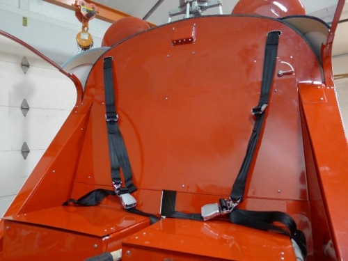

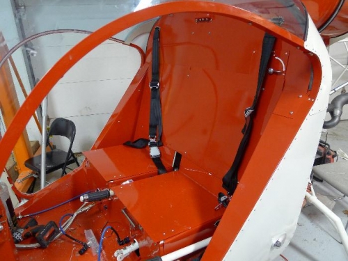

Brief Description:  Final Install of Interior Sheet Metal
This should have been a very short job, but as always not. The biggest issue was the headboard not fitting because of the bubble. DO NOT CUT AND PAINT THE HEADBOARD WITHOUT THE BUBBLE IN PLACE.
Another change was putting the headboard underneath the seat back. Originally I had it on top, because no one told me to do it any differently. It works better underneath. A lot of fitting, removing and cutting. Overall it came out OK. If I decide I want to make it great I can always redo it.
You can see the headset plugs mounted up high and facing down. I put an antichafe material around all the seat belt penetrations.
