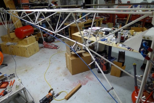

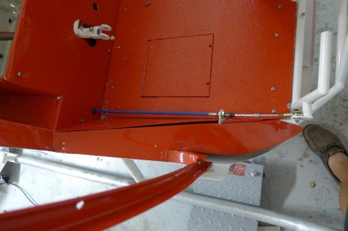

I hooked up the tail rotor and used my laser cut stainless steel standoffs. When it got to the cabin the cable was about 2" short. Scratched my head for a bit. Then I disconnected the cable from the standoffs and tugged. Sure enough it was long enough. So when you get to this part remember to hook up both ends and the cable itself will tell you how long t
Cable with Standoffs
Rudder Pedals with Penetration
