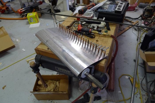

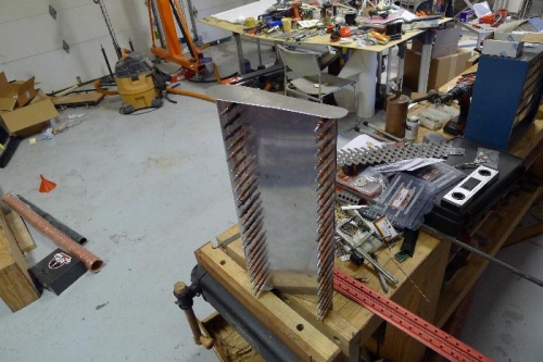

Made the horizontal stab per the drawings. I started the bend in the leading edge with my brake but only enough to start the shape and define the center. I then put it on the floor and started getting a little more physical with it. I could eventually hold the trailing edges together. I used the twin screw vice shown in the pictures to hold it even tighter. Drilled and clecoed the trailing edges first. Did the skin to the tube next. The end plate will be held on with a couple of nut plates fixed to angles that are riveted to the skin. I will take a picture tomorrow.
Trailing Edge Clecoed
All Clecos in Place
All Clecos in Place
