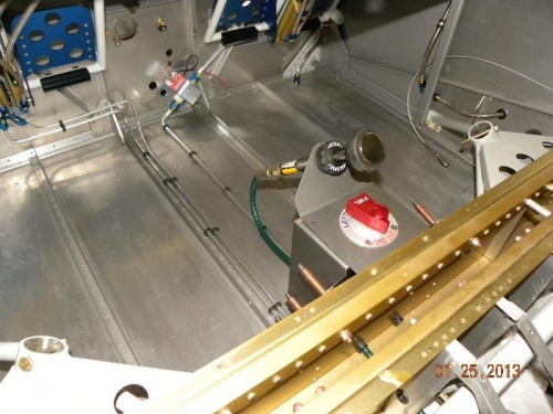

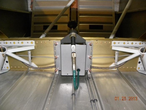

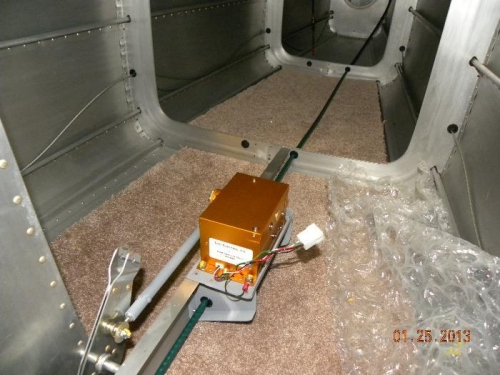

While routing the cable i found that my auto pilot servo bracket was in the way..... so I installed a couple grommets and went through it.
Also had to drill a hole and install a gromet in the closure beneath the fuel valve.
It's a pretty tight double back bend
routed through AP Servo Bracket
