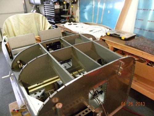

Brief Description:  Riveted Dorward Deck

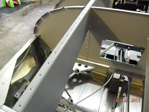

The panel substructure / forward deck is now riveted together and permanently affixed to the fuselage. I riveted this up using a combination of hand squezzer, pneumatic squeezer, rivet gun and even stuck a few cherrymax structural pop rivets in some hard to buck locations.
I mounted the pressure sensor manifold to the firewall, in combination with one of the forward ribs. Not quite what all sensors get routed through this manifold yet....
ready for avionics and canopy
presure sensor manifold
primed and rivetes
primed and rivetes
