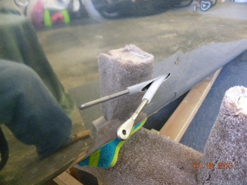

I installed the rudders cables in the fusealge some time ago but neither end is terminated yet. Near as i can tell the rudder needs to be on the plane to to the final connection to the rudder pedals.

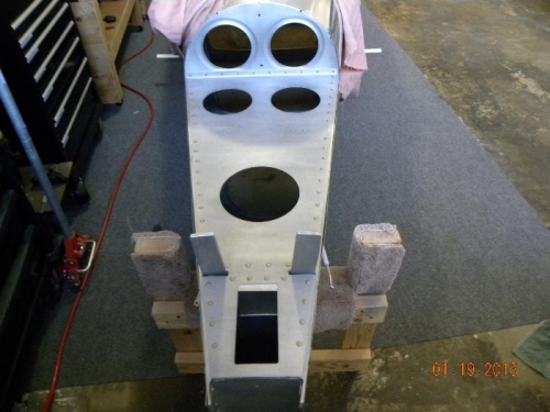

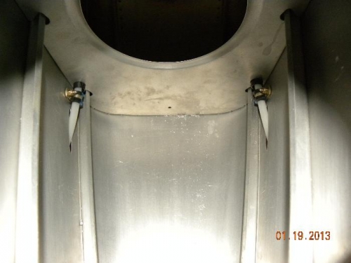

Anyway, the cables need to exit the rear of the fusealge. Thankfully the QB kit came with the slots cut on both sides and the corresponding screw hole for the adel clamp. There is a pvc sleeve shielding the stainless cable where it exits the fuse. I positioned the cables and pvc sleeves through the passage and fastened them in place with adel clamps.
rudder cable exit
rudder cable exit
Adel clamp holding sleeves in place
