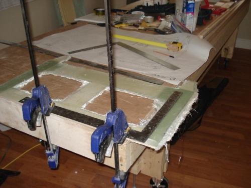

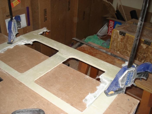

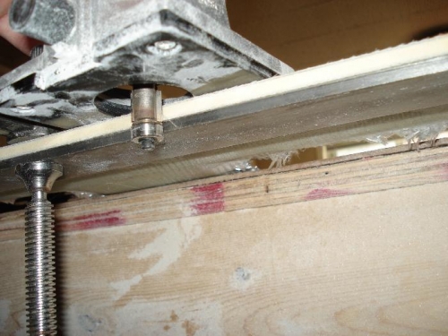

Brief Description:  F22 and F28 Bulkheads - Part 3
The F22 is more complicated but it is basically the same process. Start by cutting a straight line across the bottom and then square the sides. The rest of the edges can be measured and cut by referencing the outside edges. It involves allot of clamping and setup, but it results in a nice clean accurate finish. The only drawback is that this method is extremely dusty. It is really itchy dust too.
