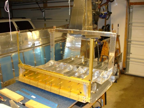

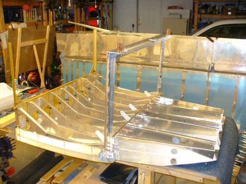

After clecoing the F-704 and 705 bulkheads to the seat ribs yesterday, I added the baggage floor ribs after seaming and fluting (barely needed). Then got out the lower skin and clecoed on. Some binding with the F-705 bulkhead towards the sides - found the seat belt anchors in two places need trimmed more for rib clearance. Will do that tomorrow.

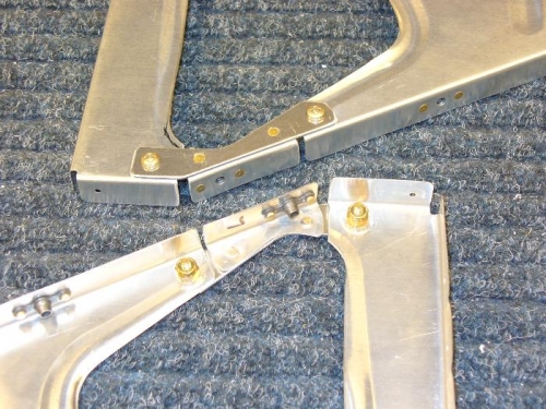

Removeable tops on two ribs as described yesterday.
Center fuse clecoed!
Another view.
Another view.
