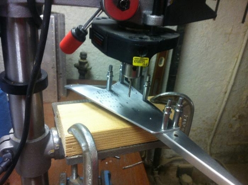

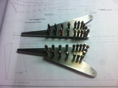

Final drilled 3/16" holes for future control rods using step drill bit on drill press. Also final drilled all #30 holes using drill press. Deburred all holes and re-assembled with clecos.

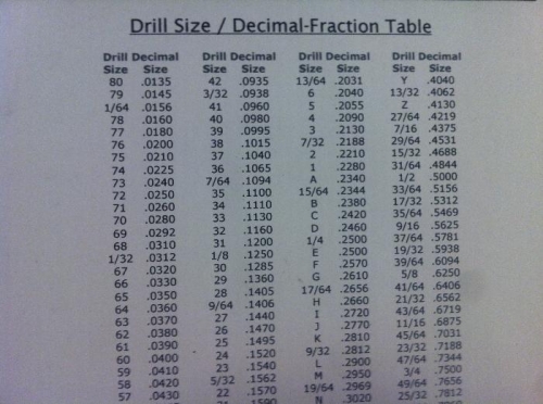

I am thinking of switching to metric system for this build to avoid all the adding/subtracting of fractions, but for now the drill size fraction table I found online has been very helpful.
Used drill press for final drill
Root ribs drilled and deburred
This chart is old-school, but very useful
