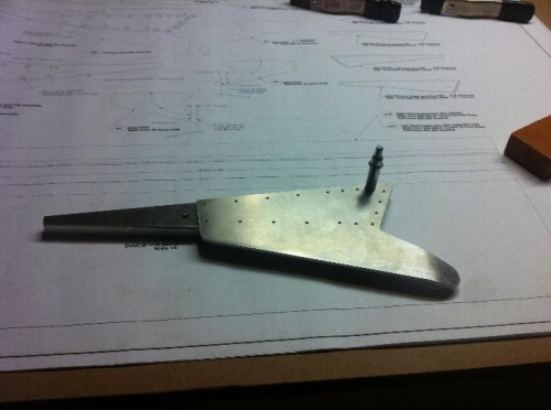

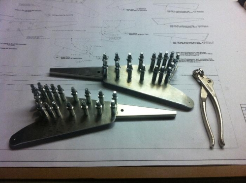

Drilled and cleco'd root rib assemblies through drive plate pilot holes with #40 bit. Final drill with #30 bit will be required.
1st Hole Drilled
1st Parts Cleco'd

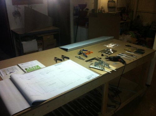

Workbench End of Day 1
