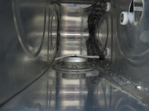

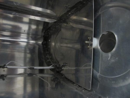

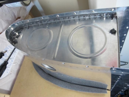

I installed the capacitance plate and trimmed the wires to the correct length. Stripping them and crimping the connectors on inside the tank was less than fun. I got the wires attached to the inboard plate and then the plate to the rib. I bent the vent line upward at the end to minimize fuel overflow on hot days. I riveted in the two end ribs and torqued down the vent tube fitting. While I still had some proseal, I dabbed some on the wiring to attach it to the vent line and made a fillet on the outside of the inboard rib and encapsulated the rivet heads. I still need to seal the inside of both ribs, the outside of the outboard rib and rivet heads and the vent tube line fitting.
Wires Prosealed to Plate
Vent Tube Bent
Vent Tube Bent
Outboard Rib Riveted and Sealed
