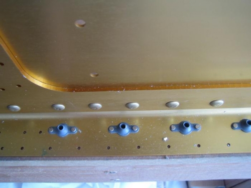

I continued working on the main spars. Unfortunately, I don't have a #28 drill for the holes in the spar where the access plates attach to the bottom flange of the spar. The aviation aisle at Home Depot didn't have any either so appears that I will be placing an order with Avery or Spruce shortly.
#40 Countersink for K1100-08 Nutplates

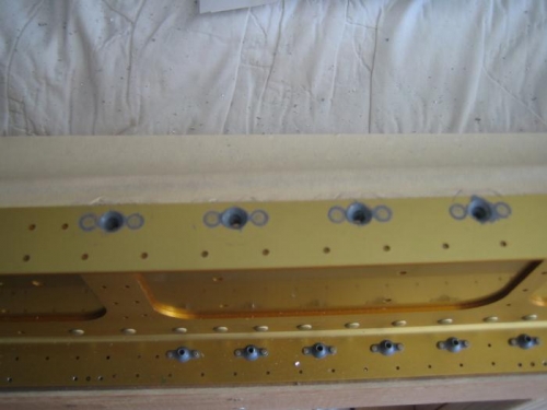

K1100-08 Nutplates Attached

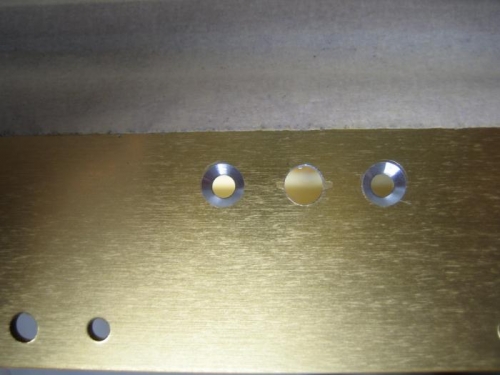

Primed Countersinks where Anodizing was Removed
