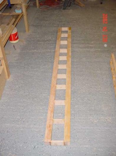

Set up a jig for fabrication of center forward spar. Cut vertical pieces. Since the plane uses
the AS5048 wing, spars are 1" taller than standard RAF 48 wing. Epoxied center spar vertical pieces in place. There was a question on how to cut vertical pieces so that it fits flush to the spar cap. Used a disk sander on the Shopsmith to make final length dimension.
Cutting verical pieces
Center Wing Spar
Center Wing Spar
