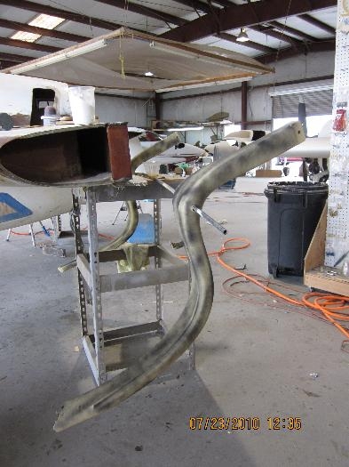

Sanded bottom of wing and strake. Primed, then put a guide coat on gear legs. Guide coat was simple black flat paint sprayed lightly in a polka dot fashion. Sanded gear legs. They were long, curvy, and silky to the touch! Microed around bottom of pilot side door using fast west.
