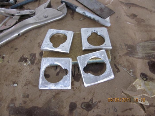

Brief Description:  Cargo tie downs, door posts
Fabricated hard points for cargo tiedown rings from 2X2X1/4 aluminum stock. See photo. Installed hardpoints by relieving hole down to outside fiberglass of floor. Used cabo, flox, and 2 bid. Microed and sanded overhead, door posts, and overhead beams.
Cargo tiedown hardpoints
