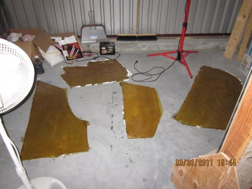

Microed and glassed with 1 bid other side of vanity/baggage panels.

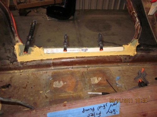

Built door sills by microing 2 pieces of 3/8" divinicel together and cuting them to shape for the door sill. Used duct tape and paint stick spacers to allow room for carpet and door seal. Microed assembly into position.
Cleaned up and opened up seat belt hardpoints.
Pilot door sill
Pilot door sill
Copilot door sil
Copilot door sil
Some vanity panels
Some vanity panels
