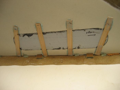

Brief Description:  Copilot strake window, baffles
Fabricated 6mm plexiglass into copilot side window. Used a router to rout outside edge down about 2.5mm for window to become flush with lower strake lower skin. Bonded with structural epoxy and flox. Used a lot of weight to let plexiglass comform to strake shape. Paint sticks bonded underneath to maintain plexiglass flush with outer surface. More work on copilot bulkheads.
Gary S has been helping me last 5 days. Great help and super craftsman! Thank you Gary!
Lots of weight on window
Paint sticks holding plexi in place
curvature of bottom strake
