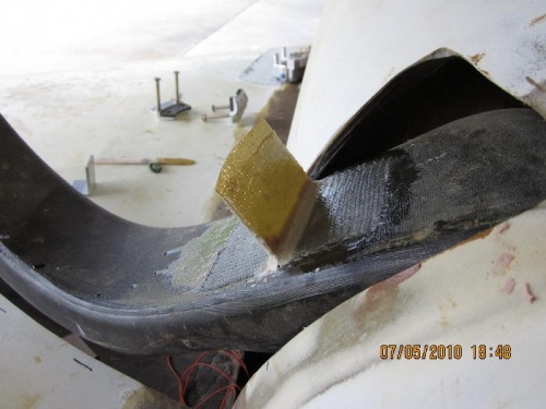

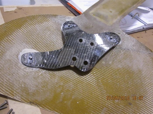

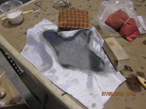

Brief Description:  Fitting gear doors
Trimmed pilot side cabo pads for spider and drilled holes in spider and pads so that bolt head was perpendicular to outside surface of gear door. Installed nut plates with 5 min epoxy and pop rivets. Layed up CP spider with 11 bid carbon. Made tabs for gear leg and attached to legs using 2 bid.
Carbon fiber layed up over aluminum
Carbon Fiber spider
Carbon Fiber spider
Tab for holding upper gear door
