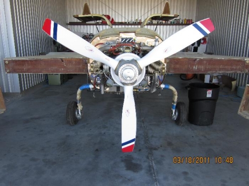

Beautiful Aerocomposite prop finally unwrapped. See picture below
Prop unwrapped!
Prop unwrapped!
