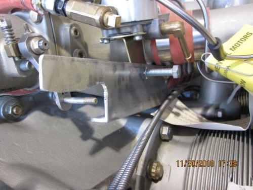

Brief Description:  Fabricate throttle cable bracket
Fabricated a new throttle cable bracket. Used 1/8 inch 2' aluminum angle. Cable clamps will be vertical on each side of the firewall end of the bracket. Standoffs used under clamp on copilot side so as to allow room to mount micro switch on bracket that is activated by contact with the throttle "shaft" which is an AN 3 bolt.
"New" throttle cable bracket
