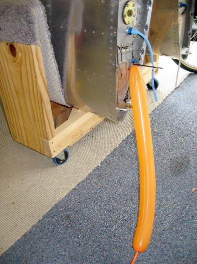

Brief Description:  Leak checked the fuel tanks
One the advice of another RV7 quickbuilder; I leak-checked both fuel tanks by monitoring their pressurized state with a balloon. That same source recommended replacing Van's leak-prone cork level sender gaskets with Permatex's Aviation Form-A-Gasket.
