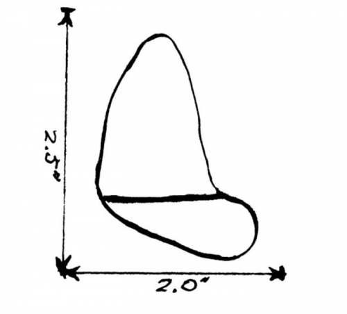

Brief Description:  Left wing attachment
Left wing incidence setting, rear spar drilling, fairing nutplates, flap pushrod installation and fuel tank bracket mounting. This all went much faster/easier than for the right wing. Attaching image of fuselage flap pushrod cutout. I never find an accurate template for this on the forums, so here's an optimal pattern to save much of the trial and error dremeling involved
