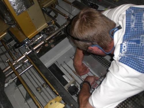

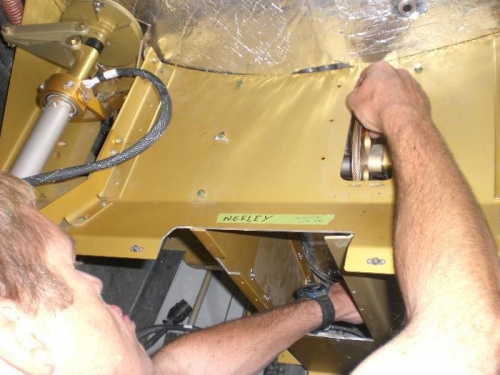

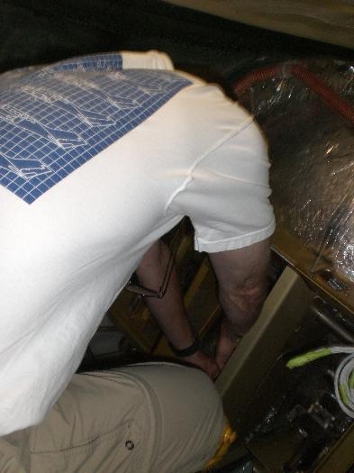

Brief Description:  Install and Rig Elevator
36. Install and Rig Elevator
connect cables to bell crank fittings. connect with machine screw, tighten
tighten cables to moderate tension
verify w/ smart level at least 38.5 degrees elevator travel (39.4 actual)
adjust to make sure up-stop hit before stick travel
- travel on elevator slightly longer than travel on yoke, so only 1 end (up travel) stopped by rudder stops
adjust elevator cables to 26"lb tension
