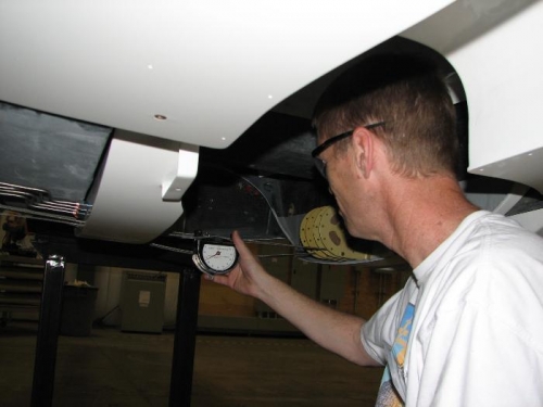

ensure push rod torque & bolt dpths are adequate
tighten rudder turnbuckles to moderate tension
insert tensiometer on cable run below plane
adjust both cables to 25-28 " lbs (26 actual) then enter rudder by tightening/loosening turnbuckles

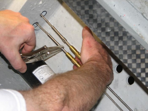

line up slots on pin & turnbuckles
insert pin clamps

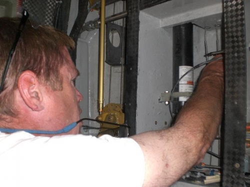

**need to create clearance on rib pass-through
-had to shorten cable by tightening at push rod connections
- unable - will have to use safety wire rather than clips to secure turnbuckle (alternate method approved)
tighten turnbuckles
tighten turnbuckles
insert tensiometer
insert tensiometer
insert pin clamps
insert pin clamps
