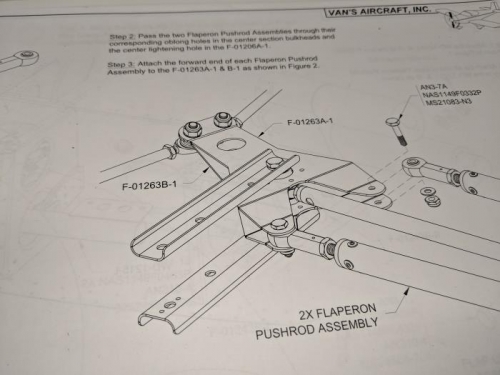

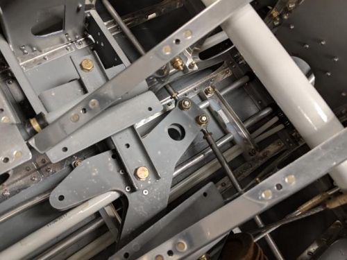

Brief Description:  Bolted control rods to flap control mechanism
I was curious why the two rod end bearings are bolted in the mixture arm. Usually you see bolts inserted from the top so that if a nut should drop. Gravity at least keeps the bolt in place.
These two arms basically tie the two control arms together and make them work as one. And they're inserted from the bottom. So if you were to lose the nuts (even if it was on the bottom), that arm is going to fall away anyway.
But, unless they both happened to fall out at the same time, you could always just grab the other yoke.
Anyway, after that was done, I inserted the two yokes and bolted them to the appropriate rods, again with the dastardly little steel washers.
