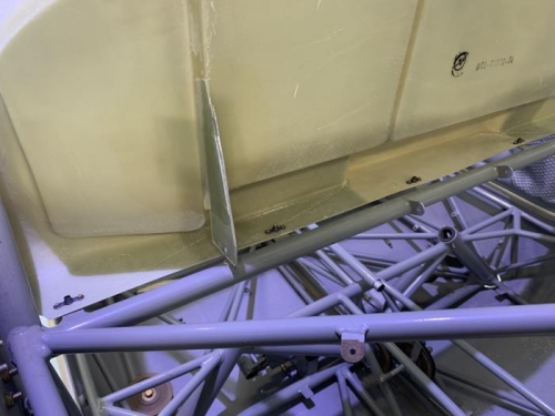

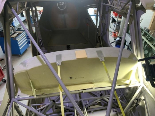

Installing instrument panel
In order to be able to dismount the panel more easily, we place it on the tabs and install nurplates - thus the screws can be acessed from below without the need to block the nuts.
Nutplates installed, panel resting on tabs.
