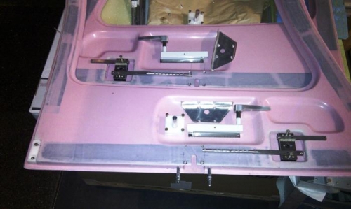

Over the last two days Dad and I have been working through the assembly and installation of the Vans Door latch and the PlaneAround latch.

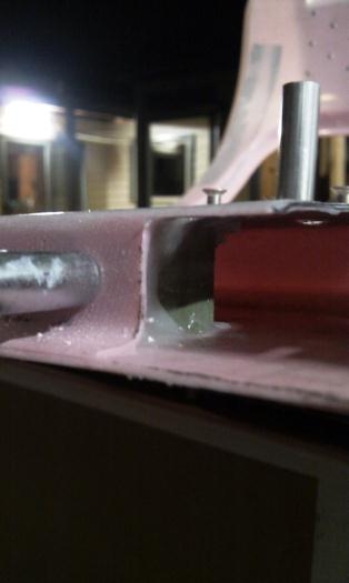

As part of the installation of the PlaneAround latch I have epoxied the fiberglass blocks into place but also I have made up some cover plates to ensure that the lower section is well supported. I will also be adding a few pop rivets to the bottom to ensure it is well supported.
