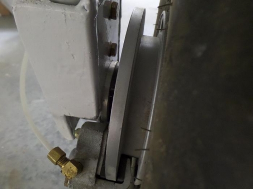

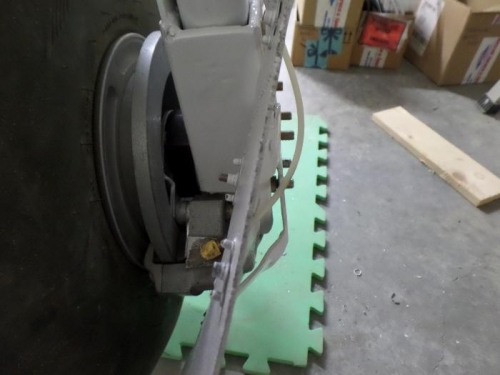

Main gear axles and brakes.
This took some time fitting the calipers and setting up the axels to have the disks free wheel.
I ended up using the spacer between the leg and the spindle with a washer to get the right spacing to have the pads not rub and jam on the brake disks.
Axles are on.
Brakes are on.
