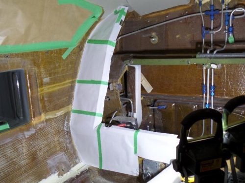

Brief Description:  Vinyl on vanity panel and prep fuselage

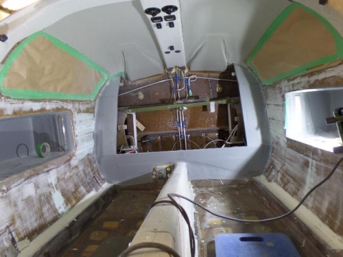

It took some time to get the paper template done and once done I prepped the Co-Pilot side and got the glue out and on. Again I used cardboard to hold the vinyl as I walk to the plane. If found a few things that I will change on the Pilots side: no relief cuts until in place. I then sanded the fuselage and filled in the low spots with micro slurry from the fiber glass cloth and mold process.

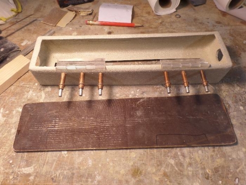

Armrest had some work also today with hinges mounted and to top trimmed.
I will be using the headliner foam in layers to get the right feel for the joystick handling.
