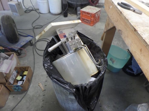

It was time to clean out the sticky wicks resin dispenser. I had some good clear resin and pumped it out; the slug on both sides went into the garbage. I used a lot of acetone to wash out the holding tanks and run through the pump itself. After 5 washes in each tank the pump was looking great again and ready for action. Then it was time to pump clean acetone through the pump its self, the acetone finally ran clear and it will sit with the lids off in the heated cabinet to completely dry out. It pumped acetone so smoothly after a good cleaning.
Bad stuff in the garbage.
