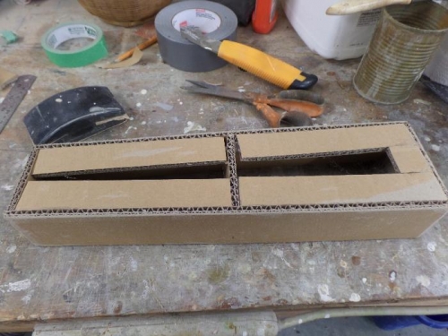

Brief Description:  Template for arm rest, cardboard was used to form

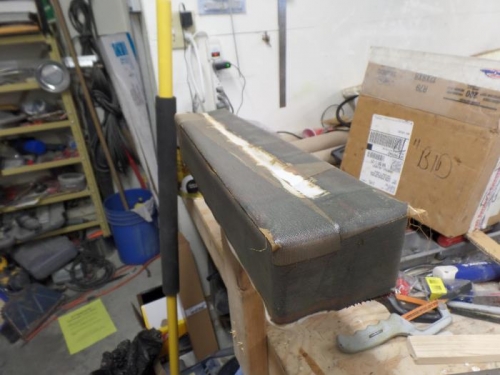

I used the good old cardboard to form the armrest and this is the only time a glue gun should be used on the aircraft. If you need to hold something on the plane used 5 minute epoxy or spot lite bondo to do the job. Back to the armrest, the bid will not go around sharp corners; it needs to have a smooth radius, so I sanded the cardboard and then added duct tape and did the 3 bid lay-up.

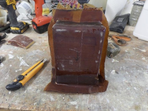

The trim box got its mounting flange cut and sanded as well today.
Ready for duct tape.
3 bids and peel-ply.
Time to trim the trim box.
