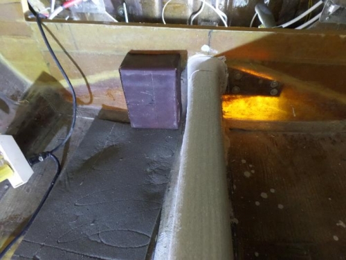

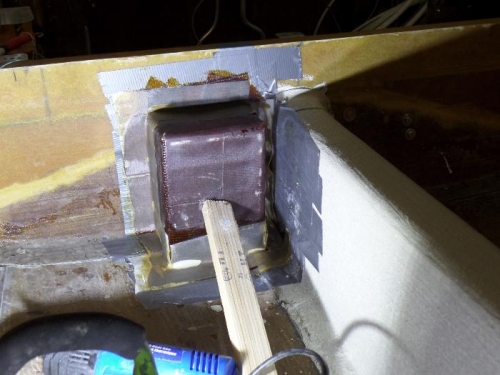

The trim box was released from the cardboard box after completely cured. I timed it and prepped with sand paper for the flanges to go on. I duct taped everything and waxed the tape so it will come off better when cured. Peel-ply next and let it sit to cure. The heat gun was used to flow out the resin and help with the peel-ply absorption with the extra resin.
I will pain the box and screw it on when the carpet is installed.
Trimmed and fitted.
Trimmed and fitted.
2 bid flange in place
