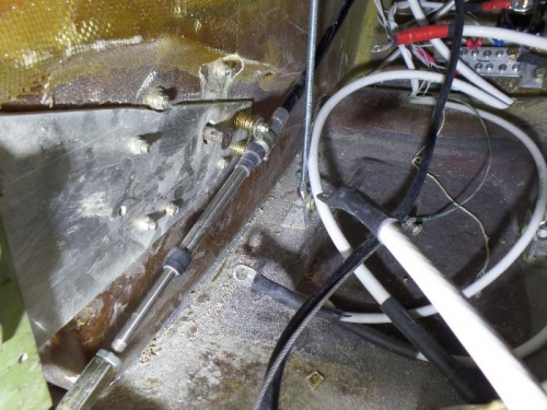

Brief Description:  The push pull cables were finally attached to the
I had to make a few trips to Lorco in Grand Forks BC to get washers and things to make this job happen today. Trial and error I got the right bolt length and spacing to have the best results for the angle and alignment. I found that the cable needed to go under the fuel line so yes they had to come out and go back in. What a pain this was, 2 hours later it was back together and fuel hose on the line to prevent any rubbing from vibration.
The trim motor rope was set up and I found the springs are to week to move the heavy duty push pull cables. I could move the holes and have a better purchase but I will try the spring next. It’s ok to have the system tight and not sloppy this way it will sit in the last position until moved.
Cable in place with clamp.

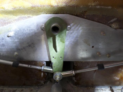

Center is done from stick
Trim rope is next.
