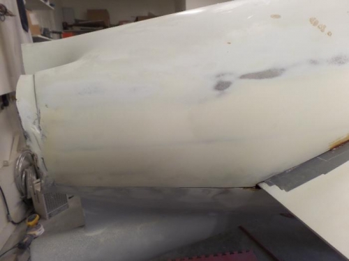

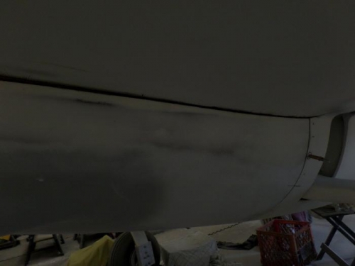

Brief Description:  Sand and gap on cowlings

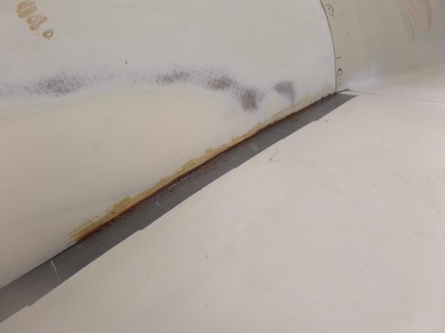

I sanded the micro that I added who knows when and now. I will be filling in the big gap with a flox mixture. One bid will go on the out side. The bottom one will be next. I am trying to have the gap at 1/8 -. I also added a small peace on the bottom cowling were the gasalator comes trough the cowling, the gap was to wide for my liking.
Micro sanded.
Micro sanded.
Micro sanded and now gaped.
Flox mix to add to gap.
