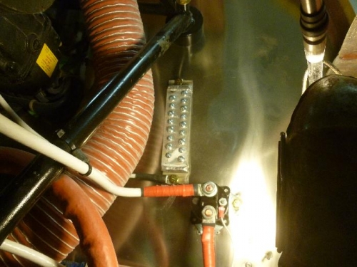

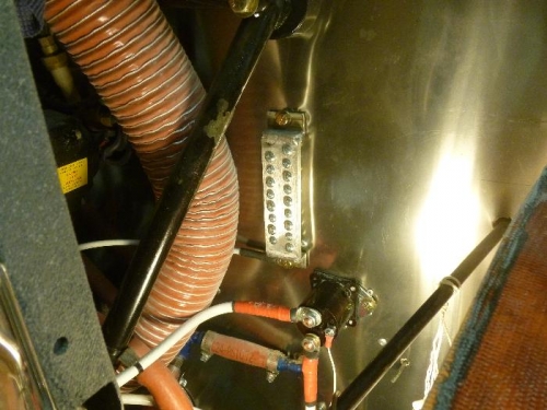

Bus bar for fire wall side.
It was time to work on the bus par for the engine area ground wile the glass is curing. I cut drilled and taped the bar then welded. Nut plats mounted to fire wall and bolted into place.

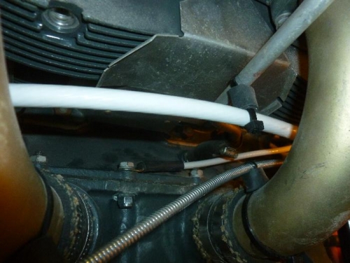

Connected to oil pan bolt.
Bus bar mounted to fire wall.
Nut plates holding into place.
