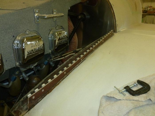

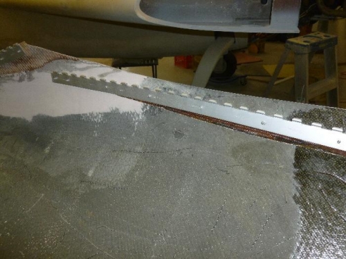

Mount hinges to cowling and wing flange.

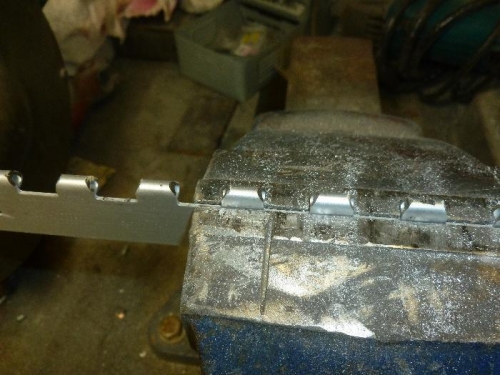

I placed the cowling into position and held with clecos and placed hinge for wing flange then drilled holes for rivets. I ground the hinge edges so they meet better and it helps for sure.
Hing is angled to help with fit.
Cowling hing riveted on.
Wing hing riveted on.
