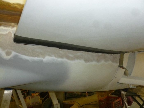

Brief Description:  Fill in lower cowling gap.

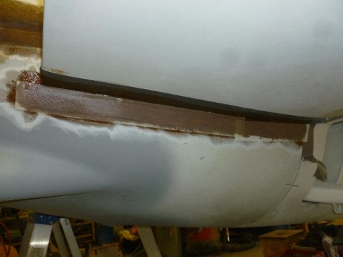

I tried to keep the gap to a minimum but after getting it to fit the bottom was ½” to ¾” wide so I will need to fill in with one bid on the outside and add flox mix with 2 bids on the inside, this way I will be able to sand the correct clearance for paint. The fiber glass cowling can easily be fixed if things go wrong or just don’t fit.
Sanded with duct tape in place
One bid and peel-ply.
