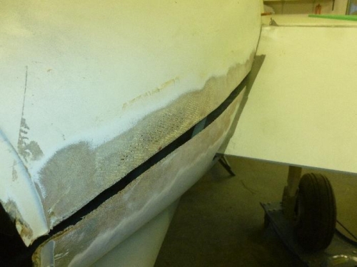

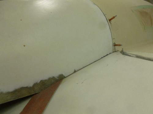

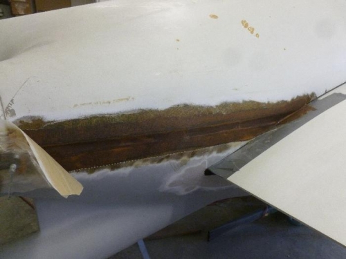

I spent a lot of time sanding the gap on the upper cowling to fit the wing with the correct gap. I then put the bottom cowling on and fitted as well. The cowling is now ready to be joined with glass (bid) in and out, one bid out and 2 bids on the inside. I used a clamp on top of plastic to hold the ends even. Peel-ply was added on the out side.
Gaped to fit correctly.
Ready to join upper and lower cowling.
One bid out and 2 bid inside.
