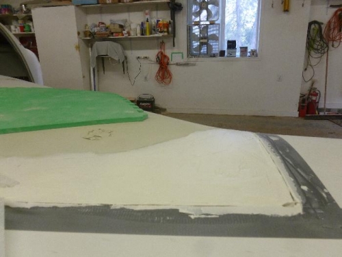

Brief Description:  Added micro to sanded areas on the strake and wing
I sanded the areas were the micro is to be placed and then duct taped the side were no micro was to go. The duct tape works great when sanding with the orbital sander with 60 grit to protect the side that doesn’t need sanding. I then remove the duct tape and sand the edge and blend with 120 grit paper on the air board.
Micro is on.
