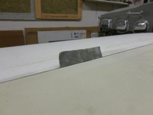

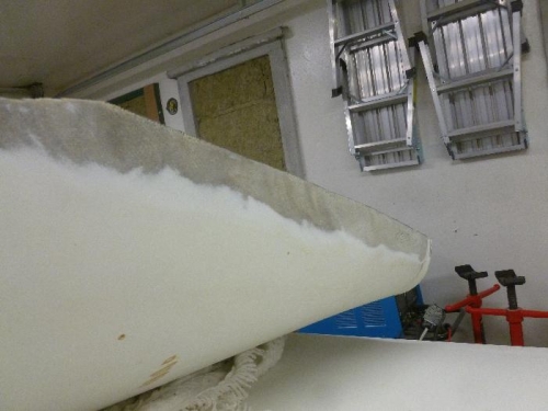

Brief Description:  Gap wing and cut cowling for fitting.

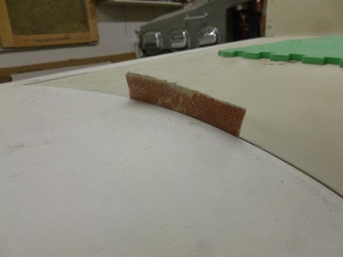

I got the wing up to the cowling and had it all level to mark out for the cut. I then cut the area under the line and will sand to fit. I removed the cowling and bolted the wing into place and started sanding the gap. I used duct tape on the backing of the 50 grit sand paper and worked my way up to 5 layers one at a time. The wing is sanded and not the strake. I will add up to 7 layers of duct tape for now and then fill to blend the wing to the strake.
Cowling is cut to fit
Gapping the wing to strake.
Up to 5 layers of duct tape
