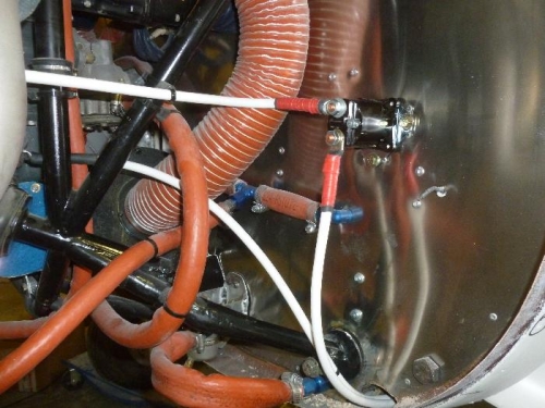

Brief Description:  Wire in starter relay and starter.
I riveted anchor nuts to the fire wall to hold the starter relay onto fire wall. Next was to run # 2 wires to the relay and add crimped bolt on ends with heat shrink and red electrical tape for positive. This worked out well and now the starter is set to go with one wire from the ignition switch to the starter solenoid.
