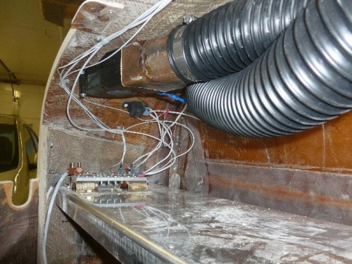

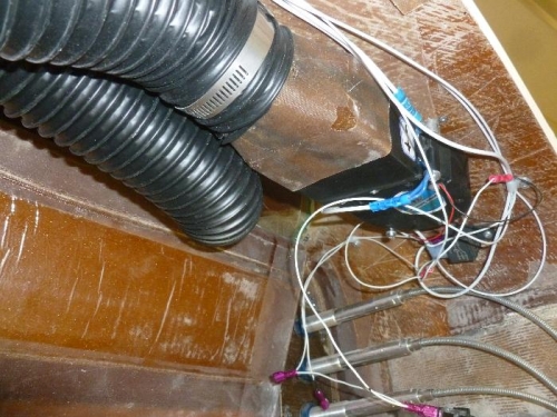

Brief Description:  Running more wire for defrost and power bars.
I ran wires to the relays that will operate the 20 amp 12 volt heaters used for the defrost system. I ordered rocker switches to help operate this function and will show up soon. The power bars have wires connected to them and will work very well to keep things tidy in the front end of the plane. There will be a negative power bar in the back as well. The battery will be mounted in the back because the seats I will be installing are heavier then the factory seats and need to move weight to compensate for that. I made a tray area for the battery to sit on, brackets will be used to hold in place. Main power relay will be in this area as well.
30 amp relay in place.
Power bar has wires attached.
