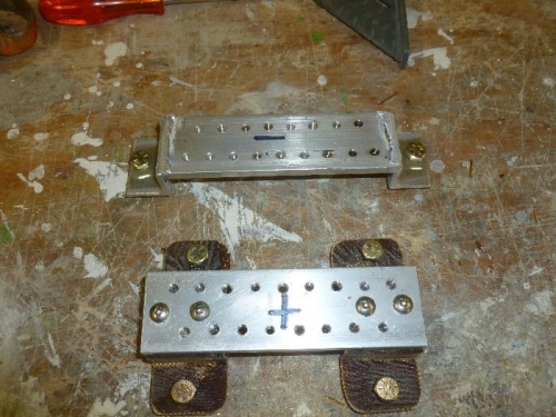

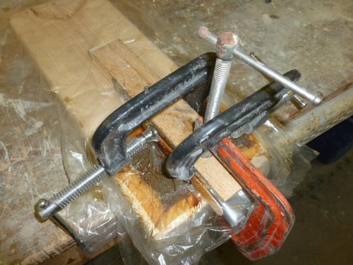

Brief Description:  Made power bar for positive and negative.

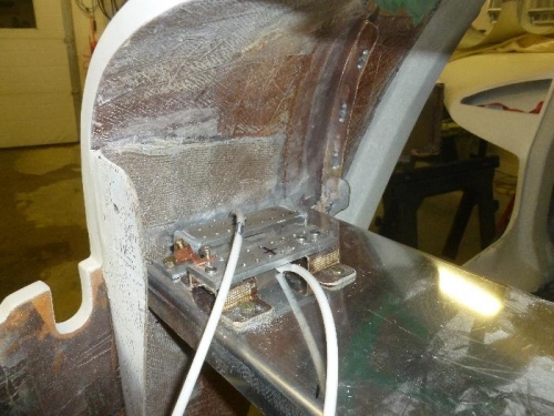

This was fun to make. I drilled and taped the power bars for 10/32 and 8/38 screws for wires to connect too. I did some tig welding on the negative one and made some insulated brackets for the positive bar out of 3 triax lay-ups. I then ran the # 6 wire down the fuselage conduit to the power bars mounted on the avionics tray. I have electrical connectors to mount the wire to the bars for the 60 amps needed for the front end if everything’s running at the same time.
Making insulated brakets.
Taped, welded and ready
# 6 wire for the heavy load.
