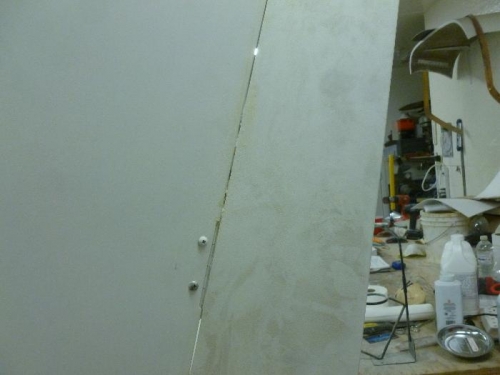

I gaped parts for paint.
I gaped the rudder and cowling to have clearance for paint. I used 120 grit sand paper with 5 layers of duck tape on the back and sanded the rudder side only.
This should be good.

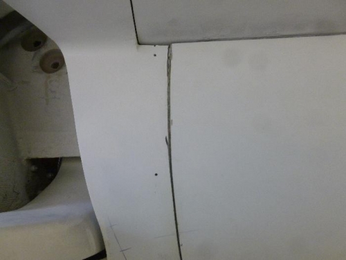

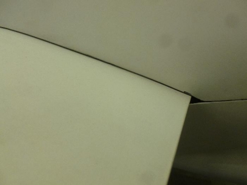

Cowling was gaped to wing.
Cowling to fuselage gaped.
