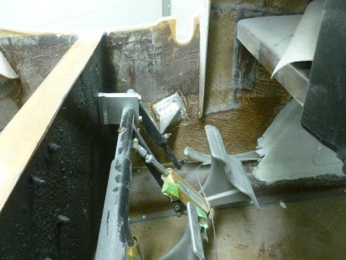

Brief Description:  Clean up mess and make petal stop.
The petal stop was made and installed. This will stop me from pushing the rudder pedal to far and over pulling the cable doing damage.
The manual said to use I beam for the pedal stop and it would be to short for the job, so I made one from my aluminum stock and tig welded it up. It was riveted and structural adhesive used to hold into place.

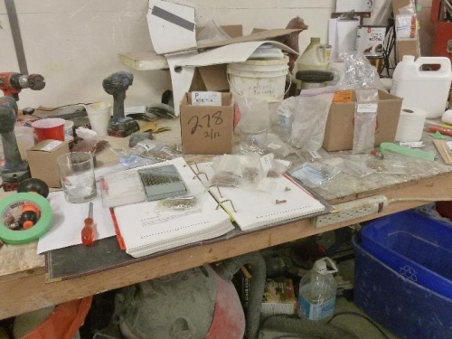

What a mess on the bench .
