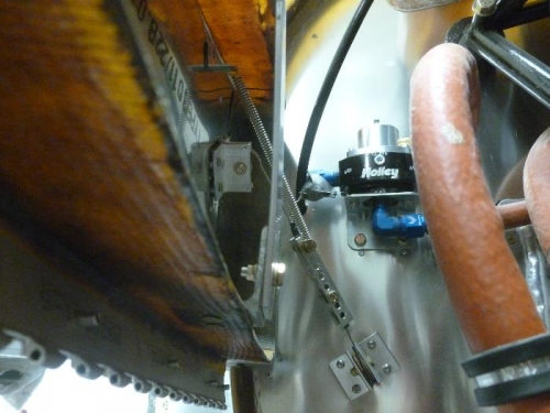

Brief Description:  Worked on getting the rudder on the Pilot side.
The parts I needed from Aircraft Spruce came in and now I could do the cable ends. I hoped on the Youtube to see how to crimp the ends and found out the Zink crimps I ordered are for Galvanized cable and not stainless, lucky there was enough in the pile of stuff to do the job. They have to be Tin covered copper.

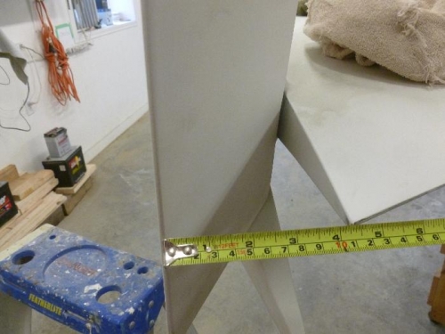

I have over 4” of rudder travel when finished with the set up.
At the rudder end the bolt was rubbing inside so the die grinder cleared the area and all was well.

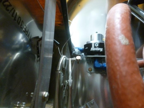

Time to crimp the end.
Happy, over 4
Happy, over 4 "
