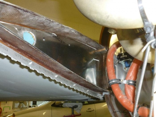

Brief Description:  Stainless was cut and riveted into place.
The end of the wing needs to be protected from engine compartment heat. Fiberfrax is under the stainless to absorb the heat. I rived the items to the end of the wing as they will not be removed. The wide section of the wing end of the stainless was cut, blind nuts installed so this section could be removed so the wing bolt will come out.
Stainless in place.
