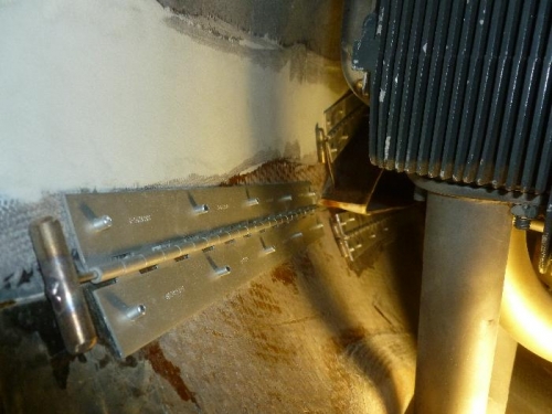

Today I placed the cowling and installed the hinge pins and then gapped the areas to have 1/16 + for paint. I found they were hard to pull out with sanding dust and no oil. I will not add lubricant until painted. All hinges are sanded to a 45 so the slide into each other and this works fantastic for alignment.
Pins are in place. Works great

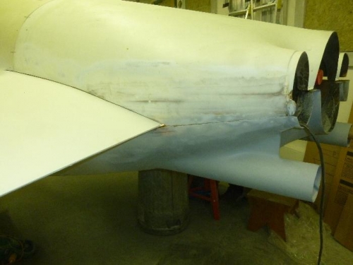

Cowling in place.
Cowling in place.

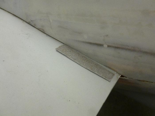

Gapping the cowling.
